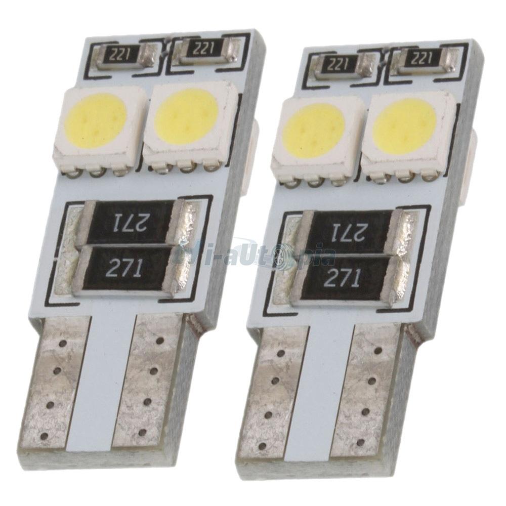

  12. Oh wow, that's no good I got mine off of eBay. Here they are, same seller. http://www.ebay.com/itm/2X-Error-Free-Canbus-T10-W5W-194-168-2825-2821-Car-White-4-SMD-5050-LED-Light-/400562954847?pt=Motors_Car_Truck_Parts_Accessories&hash=item5d4369a25f

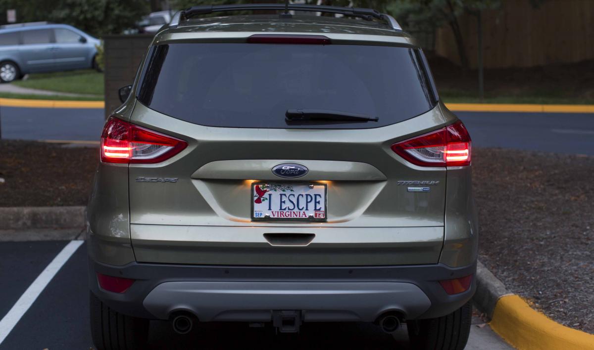

  18. And then I had to add LED license plate lights.

  20. And the finished product. Also aligned my rear hatch since the lights might of made the bad factory/dealer alignment stand out.

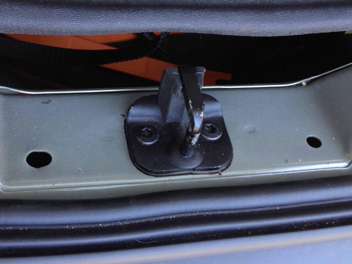

  21. Like I said, the photo's never tell the whole story. It is also twisted but the other set of bolts are only accessible by removing the headliner and that is too much. Because of the body and liftgate design of the lenses, if they are out of alignment by an 1/8" (which mine was, never put calipers on it) then it is very noticeable. The horizontal gap at the bottom in relation to the bumper was also very noticeable. Also, in the oasis message, if I recall, the time allotted to fix the hatch was like 2.6 hours. It took me about the same. Thanks for your reply. Its always so nice to hear from you.
  22. Screw the dealer. They had 2 attempts and it still looked like crap, so I did it myself today and I'm very happy with the results. This operation was a GIANT PITA. Also, CAUTION, this DIY is not for the unskilled!!! The support arms are under tension so things can go south in a hurry!!! In one picture you will notice my passenger side needs to go up. It looks a lot worse in person than in the photo. I marked the location of the hinges and striker plate. You MUST remove the support arms in order to do this or they will just push your door backwards. And don't forget, you have to support your door first. I needed to move the door to the left 1/16" and the right side up a heavy 1/16"". This is what my marks looked like after movement. Then I tackled the striker. Mine was on with blue locktite and I swear I thought the T40 driver was going to break. I have never encountered a bolt on this tight. Again, using a sharpie I outlined the plate before starting. Moved it about 1/16" to the right. It is a great design for non movement because the bolt is an oval head and the plate has a conical countersunk recess. The PROBLEM is when you adjust it will just keep going back to the original factory location. So to overcome this I used washers to ride above. I put it on as frigging tight as I could and crushed the washer a little and I'm confident it won't move. But I may buy another striker plate and have my welder friend just fill in the countersunk holes. Then I can put it on the milling machine and make proper through holes and use grade 8 flanged bolts. Or I can use the plate I have and just drill through the plate in two other location and tap it using like a 10-32 and "lock" the plate in position.
