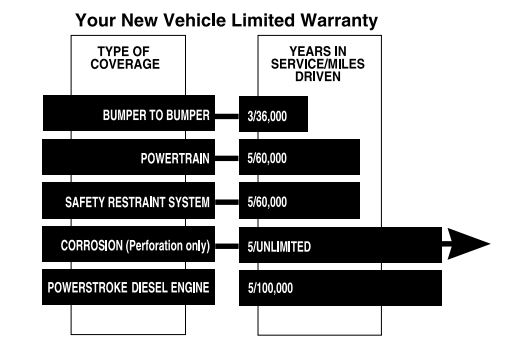

theoldwizard Posted January 31, 2017 Share Posted January 31, 2017 (edited) You have a 7 yr/100K mile warranty on the transmission and TCM. From the 2014 Warranty Guide Also ... Maintenance/Wear The New Vehicle Limited Warranty does not cover: (1) parts and labor needed to maintain the vehicle; and (2) the replacement of parts due to normal wear and tear. You, as the owner, are responsible for these items. See your Owner’s Manual. Some examples of maintenance and normal wear are: oil changes oils, lubricants, other fluids oil/air filters tire rotation/inflation cleaning/polishing clutch linings wiper blades wheel alignments and tire balancing brake pad/lining (1) Your vehicle’s Powertrain components are covered for five years or 60,000 miles, whichever occurs first. . . . Transmission: all internal parts, clutch cover, seals and gaskets, torque converter, transfer case (including all internal parts), transmission case, transmission mounts Edited January 31, 2017 by theoldwizard Link to comment Share on other sites More sharing options...

akirby Posted January 31, 2017 Share Posted January 31, 2017 From the 2014 Warranty Guide This was a special extended warranty from Ford, although apparently it only covers some of the 2014 Focii built before june 15, 2013. 14M01 - TRANSMISSION CLUTCH SHUDDER / TRANSMISSION INPUT SHAFT SEAL WARRANTY EXTENSION This applies to 2012-2014 Ford Focus equipped with the DPS6 transmission built at the Michigan plant between August 1, 2010 and June 15, 2013 * Ford is extending the warranty (fully transferable) on the DPS6 transmission input shaft seal, clutch assembly, and firmware updates to 7 years/100,000 miles. This takes effect after expiration of your 5 year/60,000 mile powertrain warranty. * If you already have more than 100,000 miles on your car, they are still extending your warranty until January 31, 2015. * There is a whole new clutch coming out: Revision "F" The clutch is still made by Luk. * There is a new input shaft seal, part number identifier changes from C to D. * As of July 21, there is an all new software flash. Link to comment Share on other sites More sharing options...
