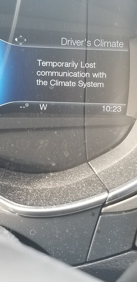

POS Posted February 6, 2022 Share Posted February 6, 2022 My 2015 Ford Fusion is a sexy car, but is a piece of shit sometimes. I keep getting a notification in my upper right screen saying "Temporarily lost communication with the climate system. When this happens I get no heat, and cannot control the whole right side of my vehicle from the drivers seat. Windows, mirrors, radio, locks. Ford dealer has never heard of this. Right after the warranty is over, the $30,000 POS slowly falls apart. I call it a recall wagon. Quote Link to comment Share on other sites More sharing options...

akirby Posted February 6, 2022 Share Posted February 6, 2022 In case you’re actually looking for help and not just venting, I’d start by replacing the hvac controller. If it’s bad it could be overloading the bus causing the other failures. Quote Link to comment Share on other sites More sharing options...
