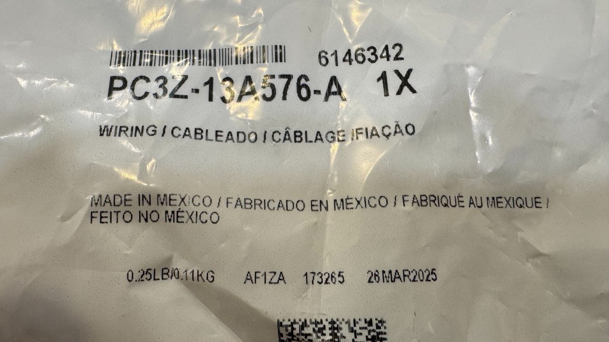

geekgirl Posted April 28, 2025 Author Share Posted April 28, 2025 I'm replying to my own post to say that we were finally able to get the tailgate removal kit from the dealer. For anyone else who may be searching for this, the number listed on the package is PC3Z-13A576-A 1X. I forgot to take a photo of the contents but it did what we needed it to do. 1 Quote Link to comment Share on other sites More sharing options...

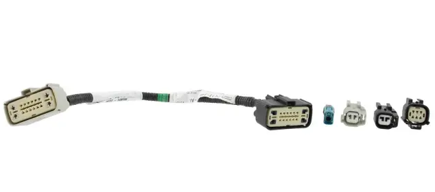

F350Zilla Posted April 3 Share Posted April 3 Thanks for posting about this, it helped me find out what to get. Here is what it looks like inside... Quote Link to comment Share on other sites More sharing options...
