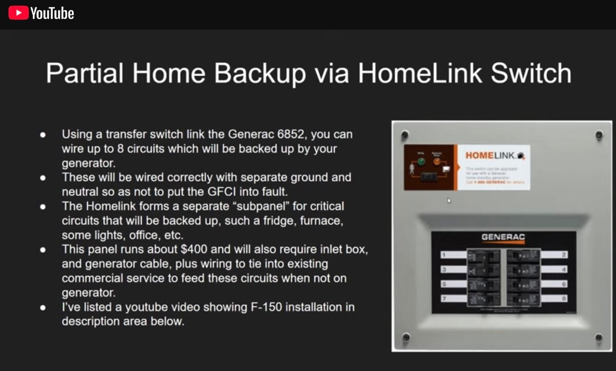

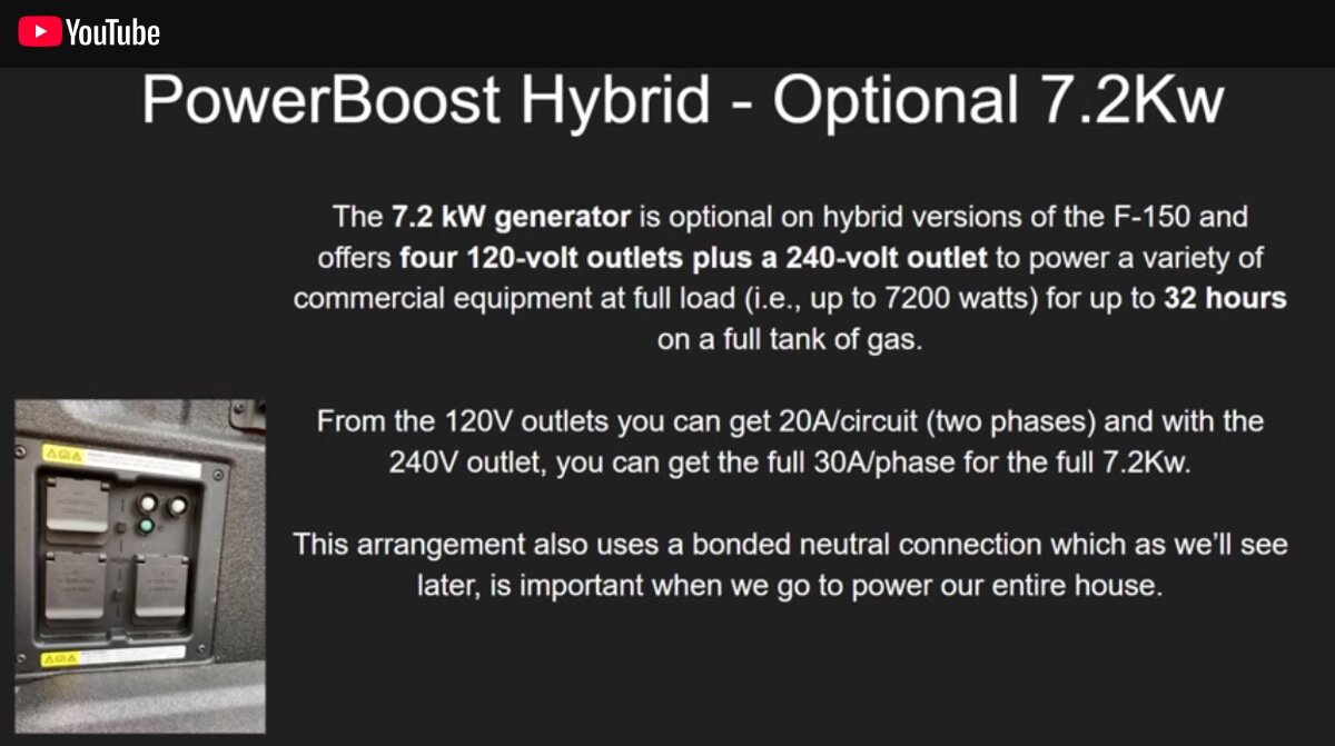

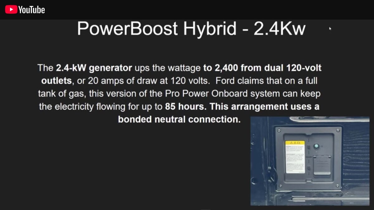

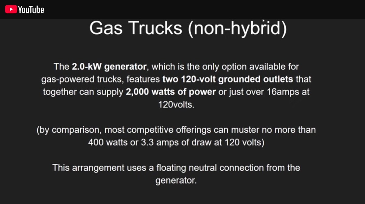

Texasota Posted September 12 Share Posted September 12 For those that might be interested in using Ford's Pro Power Onboard (PPOB) to power your house this video does a fantastic job explaining PPOB. Unfortunately, PPOB is a bonded neutral generator and this fellow explains why it won't work for your house with a simple transfer switch (it is more complicated). The link below takes you to the part where he discusses powering your home. But, if you want to learn lots of good stuff about PPOB start the video from the beginning. https://www.youtube.com/watch?v=0RKOSCdwxeQ&t=1972s 1 Quote Link to comment Share on other sites More sharing options...

Rick73 Posted September 13 Share Posted September 13 17 hours ago, Texasota said: For those that might be interested in using Ford's Pro Power Onboard (PPOB) to power your house this video does a fantastic job explaining PPOB. Unfortunately, PPOB is a bonded neutral generator and this fellow explains why it won't work for your house with a simple transfer switch (it is more complicated). The link below takes you to the part where he discusses powering your home. But, if you want to learn lots of good stuff about PPOB start the video from the beginning. https://www.youtube.com/watch?v=0RKOSCdwxeQ&t=1972s Thanks for information. If correct, it’s interesting that some PPO are bonded and others (base unit) not according to video if I heard it correctly. Seems odd to me that Ford would not be consistent on this. For reference I just confirmed that my generator is not bonded, which may explain why it worked fine powering house for entire week. Quick search suggested Honda and Yamaha are not bonded, while others are, apparently depending on power rating according to one source. I’ll keep this information in mind should Ford ever offer Pro Power Onboard in a van in US. Quote Link to comment Share on other sites More sharing options...

Texasota Posted September 13 Share Posted September 13 (edited) 3 hours ago, Rick73 said: Thanks for information. If correct, it’s interesting that some PPO are bonded and others (base unit) not according to video if I heard it correctly. Seems odd to me that Ford would not be consistent on this. For reference I just confirmed that my generator is not bonded, which may explain why it worked fine powering house for entire week. Quick search suggested Honda and Yamaha are not bonded, while others are, apparently depending on power rating according to one source. I’ll keep this information in mind should Ford ever offer Pro Power Onboard in a van in US. To the best of my knowledge all of Ford's PPOB are bonded neutral and there is not a way to change that. Some people cut off the ground prong of the plug but that is not code compliant or safe. I'm not an expert on portable gas generators but I think many (most?) can be changed from bonded neutral to non-bonded and vice-versa. Owner's manual explains how. Here is another video that describes a method to make your entire main panel a sub-panel that is safe and code compliant. This allows you to pick and choose any circuits you want to operate as long as you do not exceed the power capability of your generator. I hope to pursue this approach when I get a Ranger PHEV with PPOB. 🤞 https://www.youtube.com/watch?v=qLwr0MWOG1g Edited September 13 by Texasota 1 Quote Link to comment Share on other sites More sharing options...
Rick73 Posted September 13 Share Posted September 13 1 hour ago, Texasota said: To the best of my knowledge all of Ford's PPOB are bonded neutral and there is not a way to change that. Some people cut off the ground prong of the plug but that is not code compliant or safe. I'm not an expert on portable gas generators but I think many (most?) can be changed from bonded neutral to non-bonded and vice-versa. Owner's manual explains how. Here is another video that describes a method to make your entire main panel a sub-panel that is safe and code compliant. This allows you to pick and choose any circuits you want to operate as long as you do not exceed the power capability of your generator. I hope to pursue this approach when I get a Ranger PHEV with PPOB. 🤞 https://www.youtube.com/watch?v=qLwr0MWOG1g At beginning of first video he says that the base 2.0 kW PPO on regular gas trucks is floating. He then says that both PPO, 2.4 and 7.2 kW versions, on PowerBoost hybrid trucks are bonded. Something to keep in mind is that 2.0 and 2.4 kW PPO units are only 120 Volts and can therefore only feed one leg of house panel. This is where a small sub-panel for critical loads starts to make more sense. The 7.2 kW PPO can feed both legs so makes it much easier. I’m wondering that if Ford manufacture a PHEV Ranger or Transit Custom Van (or similar) for US, whether they will make larger 7.2 kW PPO available. I would think so based on UK specs but not sure. Quote On the more powerful 6.9 kW system, there is one outlet inside the vehicle’s cabin (10 A and 2.3 kW), and two in the load box (15 A and 3.45 kW per outlet) to meet the power demands of heavier duty equipment. Quote Link to comment Share on other sites More sharing options...
Texasota Posted September 13 Share Posted September 13 30 minutes ago, Rick73 said: I’m wondering that if Ford manufacture a PHEV Ranger or Transit Custom Van (or similar) for US, whether they will make larger 7.2 kW PPO available. I would think so based on UK specs but not sure. I didn't realize the base 2.0 kW system was floating neutral. Thanks. If you are asking about the EU Ranger (6.9 kW) vs the US (7.2 kW) difference, that is due to their voltage standard. EU/AU is 230 volts resulting in 6.9 kW at 30 amps where US is 240 volts resulting in 7.2 kW at 30 amps. I would be shocked if a US Ranger PHEV does not offer the 7.2 PPO. Quote Link to comment Share on other sites More sharing options...
