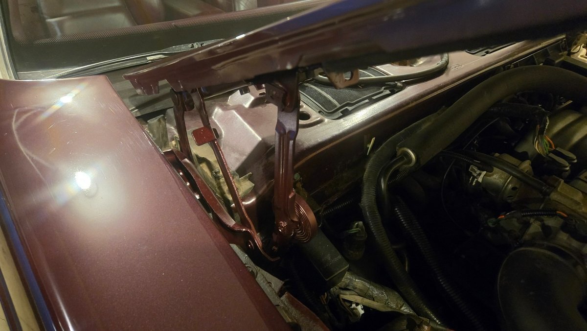

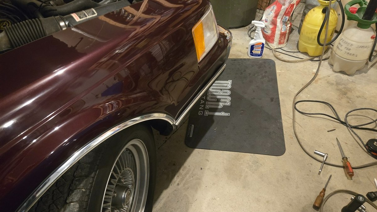

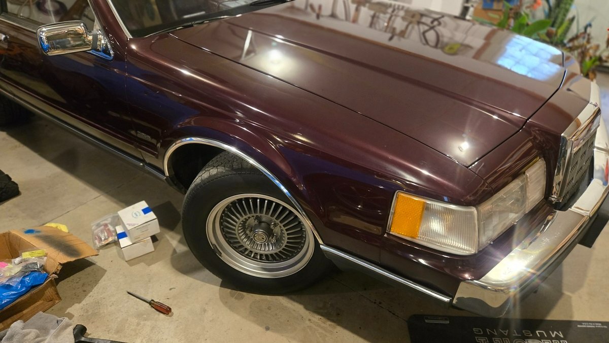

blksn8k2 Posted November 25, 2025 Author Share Posted November 25, 2025 Replaced the piece of trim on the passenger side front fender today. The trim and the bumper cover both had a pretty obvious bow in them. Here are before and after photos. Before: After: Next task will be to remove the hood hinge on the passenger side. It won't allow the back of the hood to fit flush with the top of the fender which you can see in the first photo. I already tried adjusting the hinge but it won't go any lower. When you compare it to the driver side hinge you can see a much larger gap between the hinge and the underside of the hood on the passenger side. I can't really see any obvious bend in the hinge so it might be that the inner sheet metal of the hood where the hinge bolts on may have pulled down due to the spring pressure of the hinge or someone pushing the hood too high and causing the sheet metal to flex. It's hard to see from these photos but there is at least a half inch difference from side to side in how far the center hinge pin is from the underside of the hood. Driver side: Passenger side: Quote Link to comment Share on other sites More sharing options...

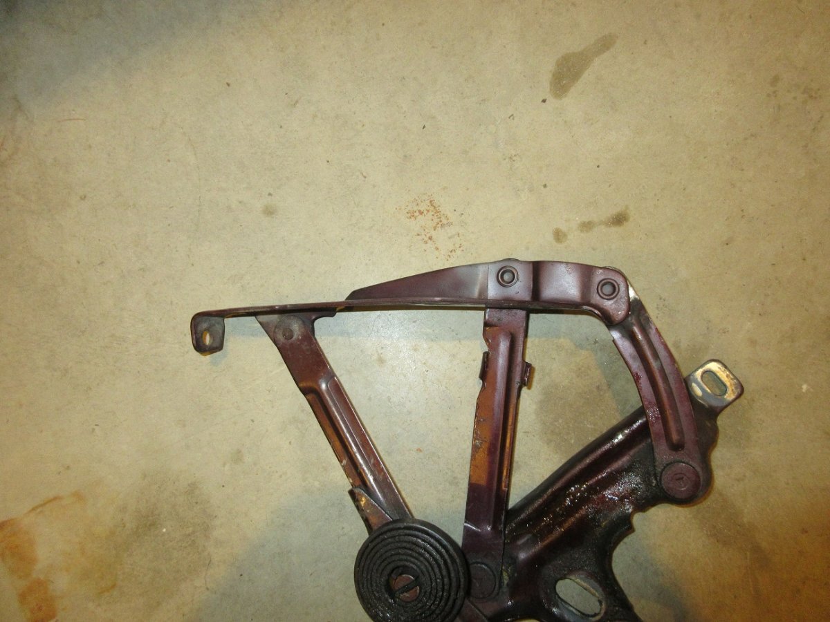

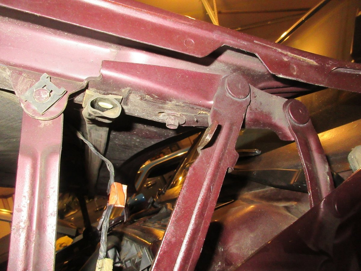

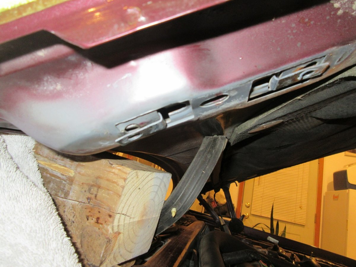

blksn8k2 Posted November 25, 2025 Author Share Posted November 25, 2025 Okay so the hinge has a definite bow in the surface that attaches to the hood. The sheet metal brace on the underside of the hood that the hinge bolts to is also puffed out at the rearmost hinge bolt hole. Between those two issues I'm betting that's why that back corner of the hood won't go down even with the top of the fender. I can straighten the hinge in a vise. I already took some of the bow out with a smaller bench vise but I'll need to finish it with my bigger shop vise. However, the hood will be more of a challenge. I'm thinking if I lay a towel and a wide board across the top of the hood I can use a big C-clamp to squeeze out that bulge on the underside. The real question is how to prevent it from happening again? 2 Quote Link to comment Share on other sites More sharing options...

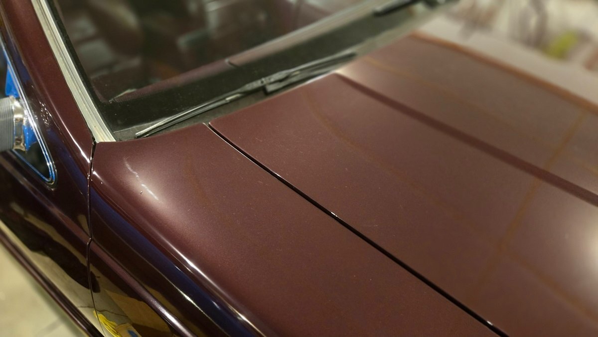

blksn8k2 Posted November 25, 2025 Author Share Posted November 25, 2025 Hood looks much better now. I guess my tricks must have worked. 1 Quote Link to comment Share on other sites More sharing options...

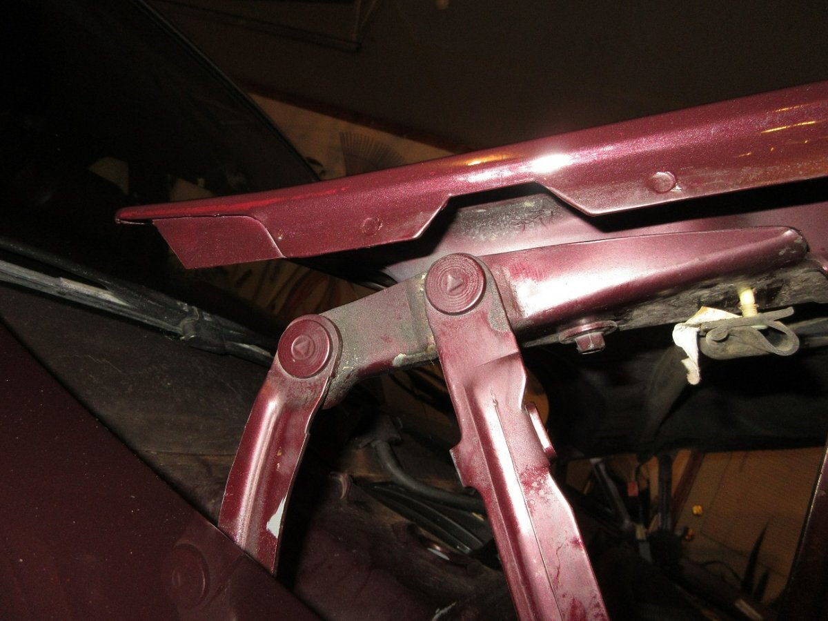

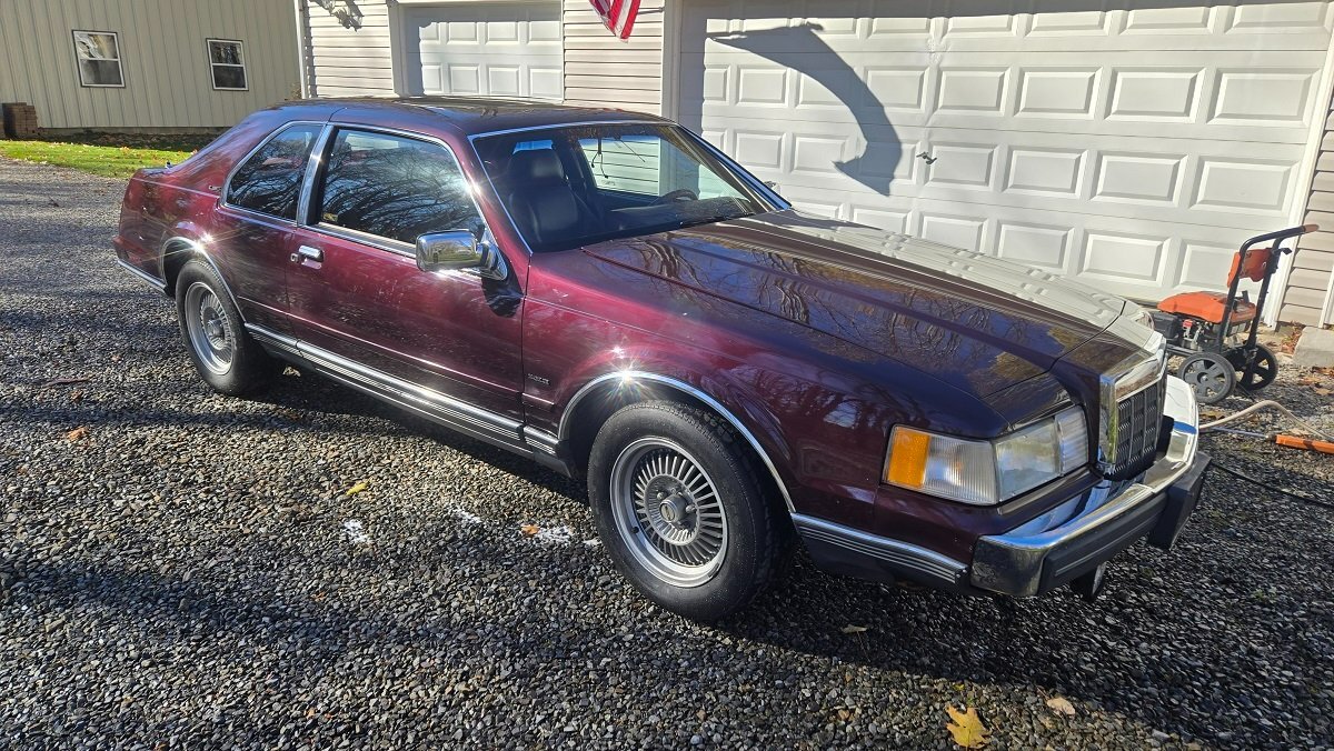

blksn8k2 Posted November 25, 2025 Author Share Posted November 25, 2025 Here's what the back of the hood looked like before I got the car. Big difference. Quote Link to comment Share on other sites More sharing options...

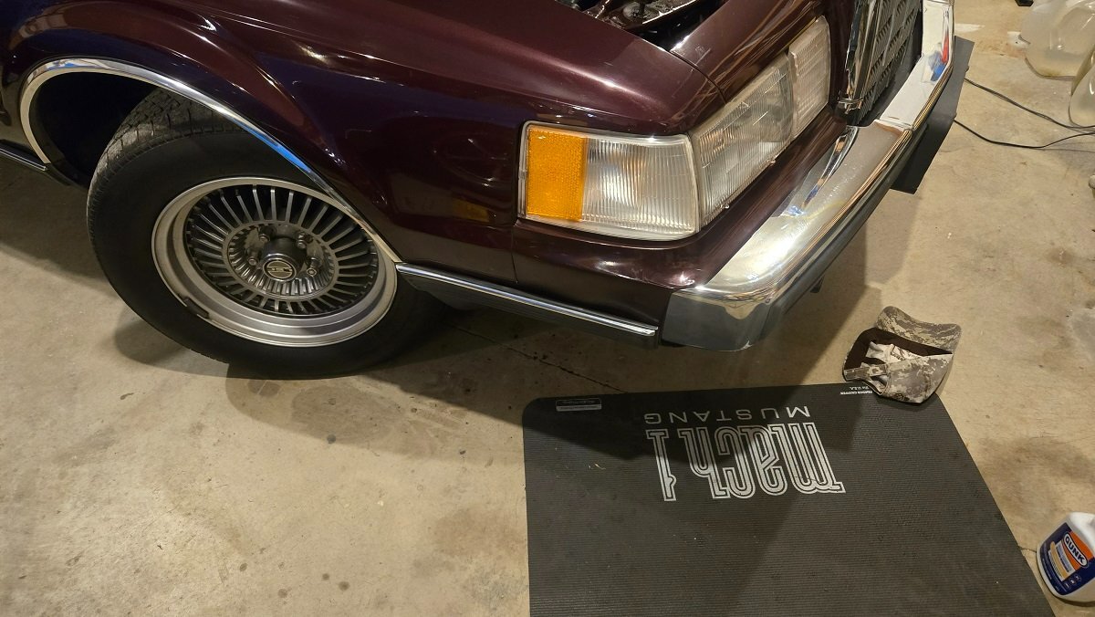

blksn8k2 Posted December 3, 2025 Author Share Posted December 3, 2025 Finally mounted one of the replacement wheels on the front. Not quite finished with that but at least you can see what it will eventually look like. Also reglued the inside rearview mirror mounting button to the windshield and reconnected the wires for the auto dimming features for the mirror and headlights. 1 3 Quote Link to comment Share on other sites More sharing options...

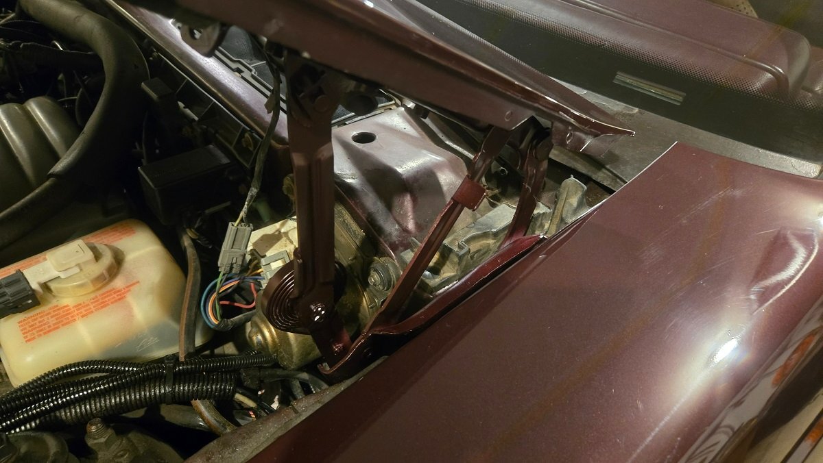

blksn8k2 Posted December 13, 2025 Author Share Posted December 13, 2025 Replaced both hood hinges today. I found a better used pair. The passenger side hinge is the one I had to straighten (it was working fine but I didn't trust it) and the driver side had a weak spring and would not stay in the locked up position. The two I replaced them with solved both issues. However, I did have to paint them because they came from a silver car. 3 Quote Link to comment Share on other sites More sharing options...
