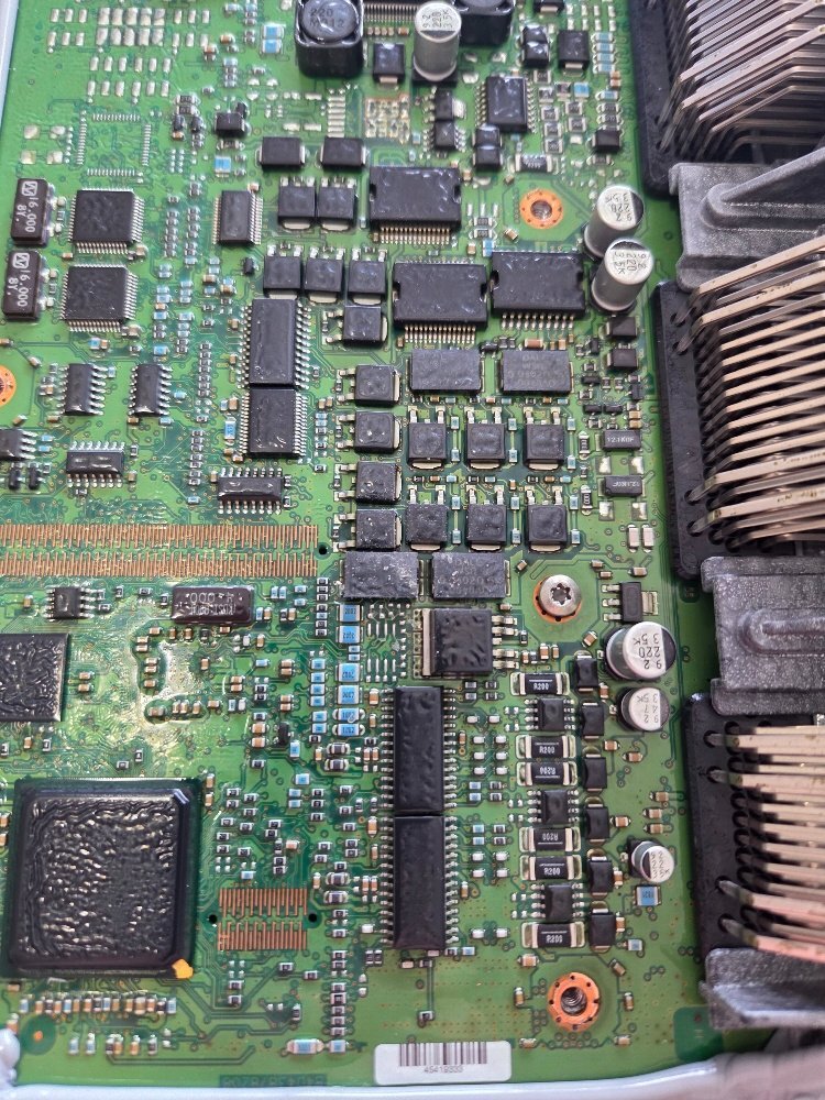

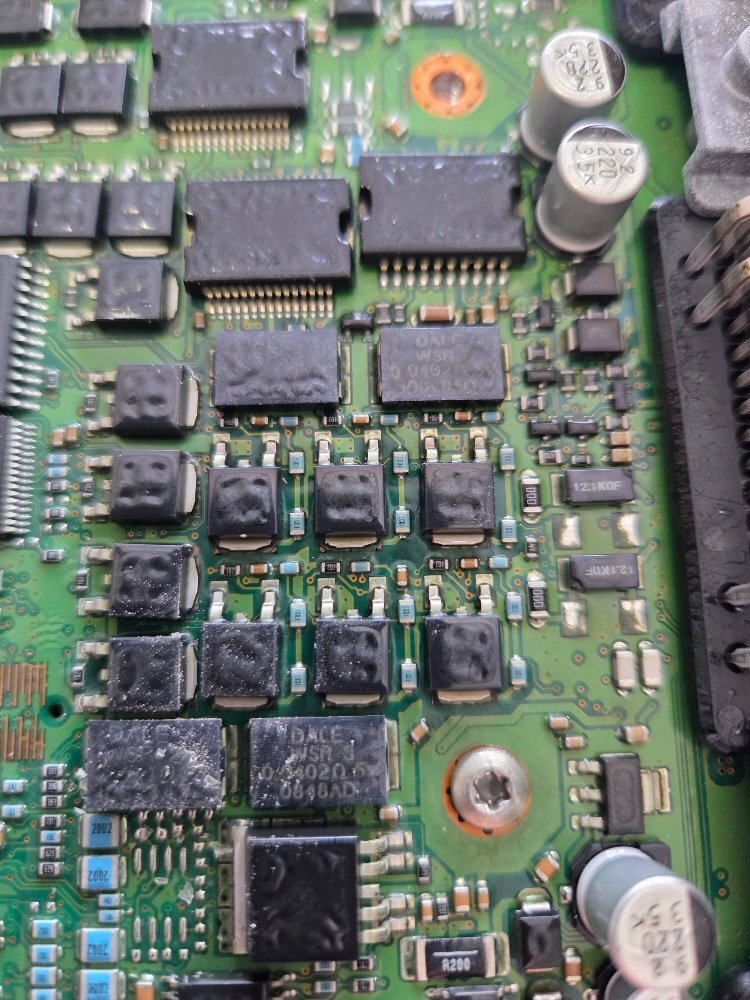

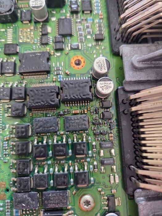

I pulled mine and opened up.
I realize that my naked eye might not identify electrical trouble, but did not see anything like I was expecting.
Attached pics...
So I am really still wondering what to do or if there is any hope for my poor MKX.
