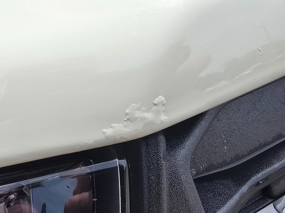

One aluminum panel on the whole truck, and it's doing the "Explorer hood" thing. 🙃
As part of my pretty frequent checking of the front end paint - hose off the bugs, check for chips, touch up chips - I came across some bubbling. Naturally, my first reaction was to absolutely freak out. I've seen tons of Explorers, and a few Edges, doing this, but not so much on Mavericks. Prowling some of the Facebook groups, I'm seeing posts just within the last 6 months, and many of them are 2024 units.

That's the claim. I've started to suspect it's in how the hoods, being the only aluminum panel on the vehicles, are being prepped for paint. I should really talk to a body shop guy about that. It's not an aluminum issue, or we'd see it on the F-150 and Super Duty. If aluminum has a different need as far as primer goes, but they run the same stuff on all the panels, that would sure cause an issue. It's super weird that it seems to happen in the same places on all these different models, and across so many years. Like really, guys, figure it out. :)

Interesting. Of those, actual galvanic corrosion seems least likely unless there's a tiny steel strip at the very tip of the hoods. Which I'm going to go check with a magnet right meow.
Aaand, I'm disappointed, I was really hoping for a steel strip in the leading edge. :) Magnet didn't catch on anything on the front lip at all.
Back to iron and/or paint contamination. Little micro-particles makes sense, in a factory setting, in THESE factories, it makes total sense.
