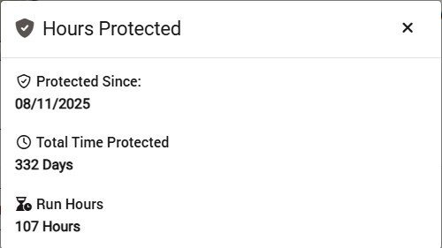

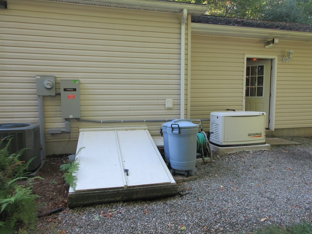

blksn8k2 Posted July 5 Share Posted July 5 My electricity has been out since about 11:15 AM on Thursday (7/2/26). Not a huge deal due to the fact that about a year ago I installed a 14kw Generac whole house natural gas fired generator. I also have a gas well on my property so I get free gas. It's now Sunday afternoon and I just got back from spending the holiday weekend with relatives. The generator has been running nearly the entire time I was gone, although the power was on when I left here Thursday morning, and it's still running right now. Utility company says they should have the power restored by tomorrow evening (7/6) at 11 PM. I get text updates periodically from the utility company so I can tell when the power goes off or comes back on along with their restoration estimates. The generator also has wifi and can monitor itself all of which means I also get a monthly operation report via email. Besides all the normal appliances I also have a couple of chest freezers and well water (with a submersible pump) so the investment in the generator was absolutely worth the cost. Because it doesn't run on gasoline and has an automatic transfer switch I also don't have to be here to start or maintain it. It might stumble a bit when I first turn on the central AC but other than that it has run flawlessly. BTW, I had the AC off while I was gone. 1 Quote Link to comment Share on other sites More sharing options...

blksn8k2 Posted July 6 Author Share Posted July 6 (edited) BTW, when I installed my Generac I had one of the local dealers come out and check a couple of minor issues and he said that if it were him he would have recommended a 20kw unit for my house. His logic was that there is not enough of a price difference between a 14kw and 20kw unit to justify not going with the larger unit. From what I saw a year ago there was still a pretty significant price difference. My total cost for the 14kw unit was less than $6k. I did most of the installation myself. The only things I hired out were the heavy gage wiring between the transfer switch box and the utility company's meter box and from the transfer switch to the breaker panel in the basement which I paid $600 for the electrician's labor. I also paid a private inspector $80 to certify the installation. The remained of the cost was in materials (generator, transfer switch, wire, conduit and concrete for the mounting pad). That same dealer installed a 22kw unit for one of my neighbors after I did mine and he paid $10k installed price for his. Had I bought mine from that same dealer and had him install it I suppose I might have been a lot closer to $10k. Hey, the power just came back on at 11:35 AM on 7/6/26 and the generator finally shut itself down after almost four days. Woopee! Unfortunately, there are more storms predicted for this evening so I have no doubt it will be running again before long. Edited July 6 by blksn8k2 1 Quote Link to comment Share on other sites More sharing options...

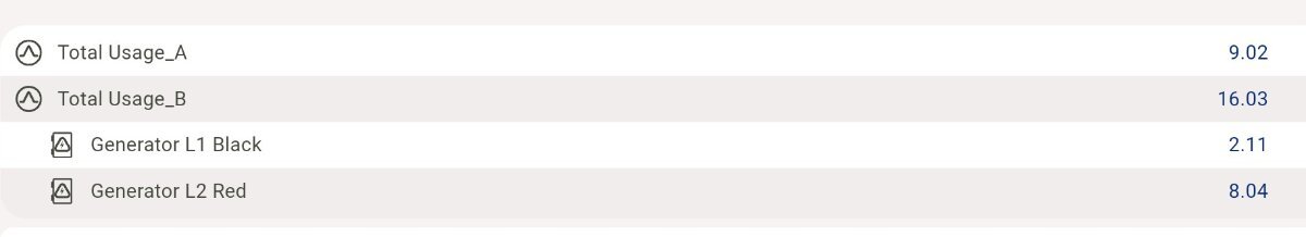

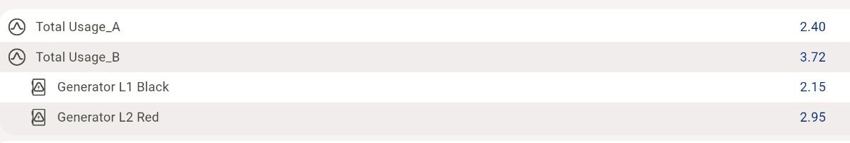

HotRunrGuy Posted July 6 Share Posted July 6 3 hours ago, blksn8k2 said: BTW, when I installed my Generac I had one of the local dealers come out and check a couple of minor issues and he said that if it were him he would have recommended a 20kw unit for my house. After installing my Generac, I became really curious about just how much power my house needs to operate. So, I bought and installed a Emporia Energy Vue 3 monitoring system, with (4) sensors. 2 are used on the mains coming into the house from the utility meter, the other 2 monitor all the circuits that are controlled by the generator sub-panel. Below are snapshots of current (pun intended) usage, the top 2 are the mains, the bottom are what is running thru the sub-panel. Yes, occasionally one of the sub-panel legs will jump by 6 amps when the sump pump kicks on, but that only lasts for 15 seconds or so. In the winter, same thing for the GFA furnace. I went thru the same calculations as most, adding-up all the potential loads, but the data shows that the actual, live usage is a lot less. The first image is without the AC/furnace running, the 2nd is with both. The value is amps being drawn. HRG Quote Link to comment Share on other sites More sharing options...
