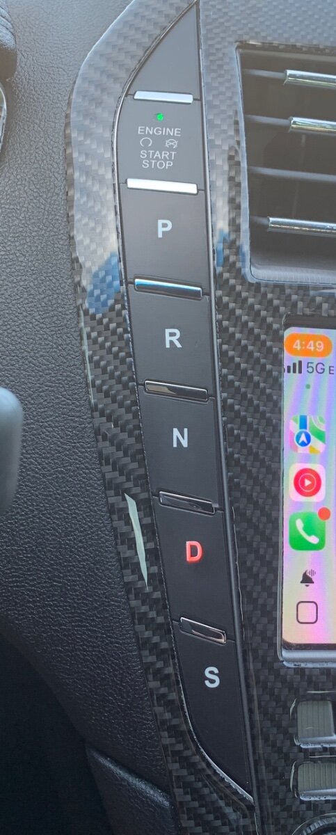

Z.Linc.Owner Posted August 12, 2024 Share Posted August 12, 2024 (edited) If anyone happens to stumble in here and you’re trying to replace your gear selector push buttons, the company link did in fact work. The finished graphic stickers are top quality. You just submit an inquiry through the website and they were back in touch with me in a day. I ended up purchasing all seven buttons for the left side because I didn’t want to just do one or two and have a chance of it not looking consistent. They charge 15$ per Button sticker + shipping. It cost me $117 to get all seven graphic sticker buttons and have them shipped. The entire side of my gear selector column looks brand new now. Yes, I even bought the sticker for the blank space above the start/stop engine button lol. Another nice touch is the start/stop button Sticker even has the small circle cut-out that allows the green light to shine right through, when the car is running. Hopefully, someone that was searching as much as I was can find this post and save a ton of time. This graphic company even produces replacements for many of the big car manufacturers. I will post a follow up that shows the finished look soon. [UPDATE] I’ve now posted a picture that reflects the installed stickers. They turned out amazing and my gear selector looks the same way it did when I purchased the car brand new. Also, the same company makes replacement stickers for the steering wheel buttons/controls. I’ve included a picture that shows those too, in case anyone is looking to fix/replace those. If anyone has any questions, feel free to reply to me on here but I can’t say enough good things about this company. They’ve been extremely professional and a true pleasure to work with. I will certainly continue to do business with them in the future. Edited June 11 by Z.Linc.Owner Corrected misspelled words and posted an update with pictures to my original post. Quote Link to comment Share on other sites More sharing options...

PetersMKZ Posted November 2, 2024 Share Posted November 2, 2024 (edited) Had the same problems with my gear shift buttons on my 2019 Reserve MKZ. Too expensive to replace the whole panel. Got some button stickers from the aforementioned autobuttonrepair.com. Followed their instructional video and it worked well except for the D which I need to redo. About $15 for each sticker. Edited November 2, 2024 by PetersMKZ Quote Link to comment Share on other sites More sharing options...
