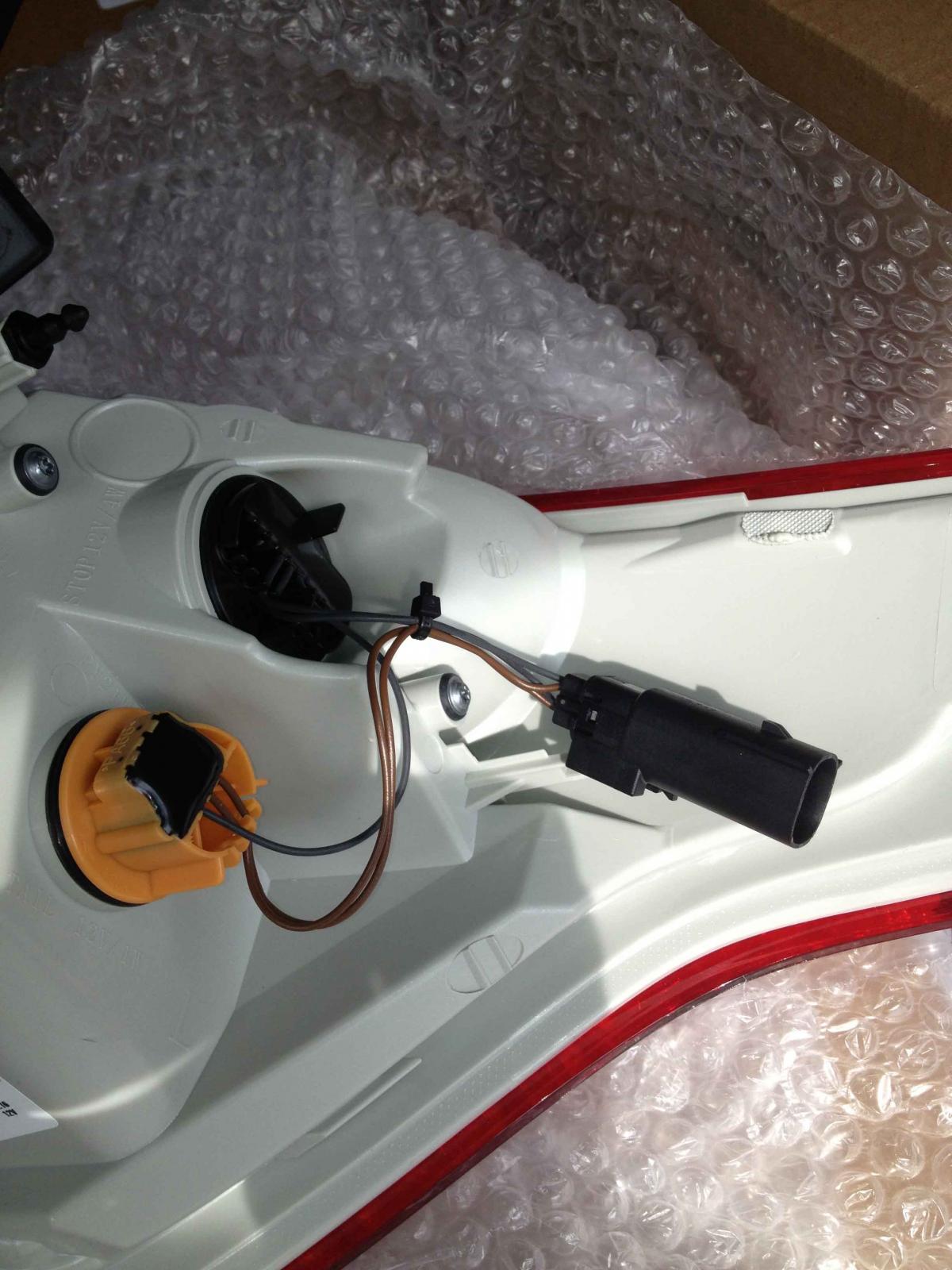

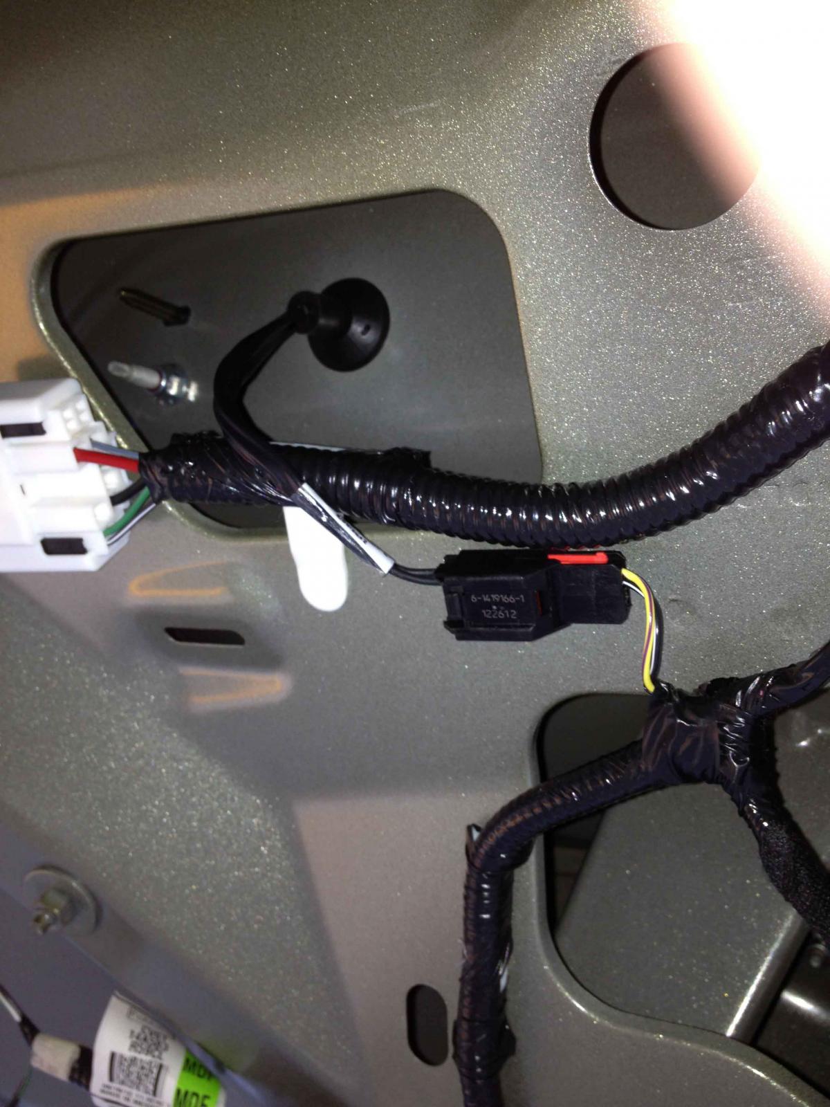

Yep, it's just adding two molex female pins, one for each connector(left and right). I wii run both of those back to the hot of the license plate, expose a section, twist it up properly and solder. Then wrap it up really good. I am doing all this on the module side of the connection, not the lense side. That way I can unplug and remove the lights at any time. I will post pics, my molex stuff is due to arrive tomorrow so guess what I'm doing Saturday.

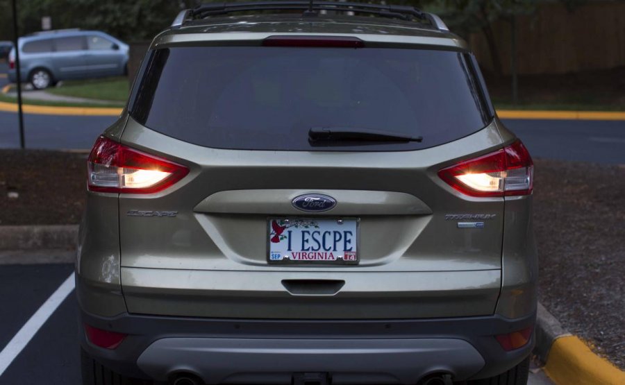

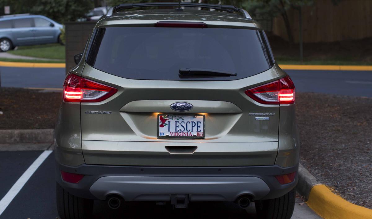

I can supply any part numbers you need no problem. But remember, you do not need to order any connectors. You just need to add a wire with a 1.5mm terminal into the connector. No, you would still have your reverse and brake lights. The new assembly just plugs right into your existing harness, which has reverse lights already in the liftgate section. What the "Euro" has is an extra connection for the LED's. So if you don't hook that up the LED "tubes" that you see in my picture on the body side will not extend into the hatch quadrant. Make sense? Your brake lights are on the same harness as your turn, and 1/2 of your running lights. This is on the body side(outside the liftgate). This is just plug and play. Watch the video again above (post #13) and you will see the LED tubes extend into where the reverse light is. Hope this helps. Pic of molex female 2x2 and female terminal This is a 4 wire connector. Only 2 of the slots are being used in the US version(hot and ground) for reverse lights. In the Euro version an extra hot is added for the LED's. The reverse lights share the ground with the LED's, hence only 3 wires, not 4.
Correct. There is no hot for the LED's on the hatch. Pretty simple. I am waiting for the female molex pin to finish the hatch LED's. It was plug and play for both the outer and inner, other than needing a hot for the inner LED's. Brakes, turn, hazard, running lights and reverse all work normal. All the molex connectors are exactly the same for US and Europe models(thank goodness). Also, one of my pics shows a close up of the license plate wires(yellow wire).
Just got them in !! For Gosh sake whatever you do, please do NOT tell my wife!! HA, anyway, it all looks good so far. I'm not going to have any time until the weekend to fart around. But the molex connector is the same, and they included the bulbs where applicable(reverse and turn). The brake light and running lights are LED. The lights that go on the hatch I may just use the license plate circuit. More to follow.

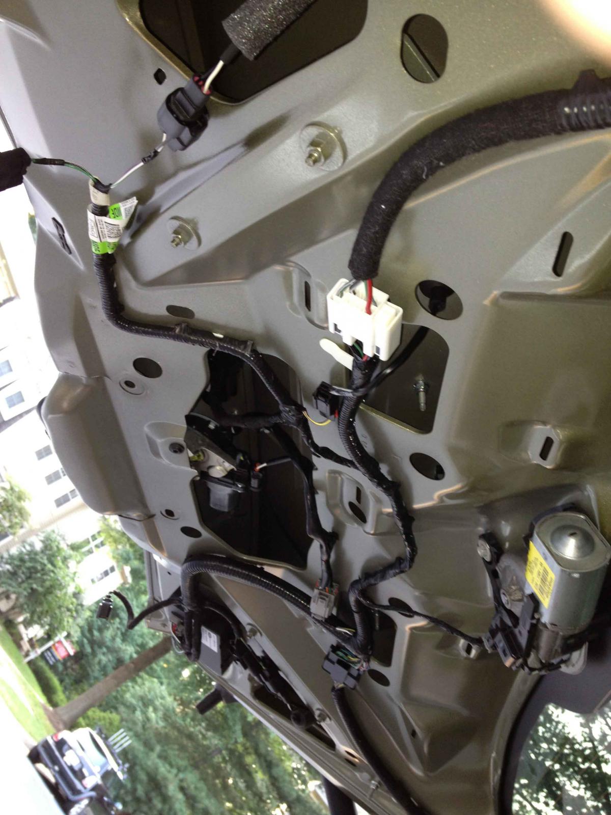

Have a question. I read on the UK Kuga forum about a grommet missing if you didn't get the hands-free lift gate feature. Well, I got the tow package so I don't have that feature. On my passenger side there is a hole in the center of the rubber grommet. The drivers side(pic included) is covered by a right angle grommet because of wiring, so that's all good. Is the passenger side supposed to be like that?
