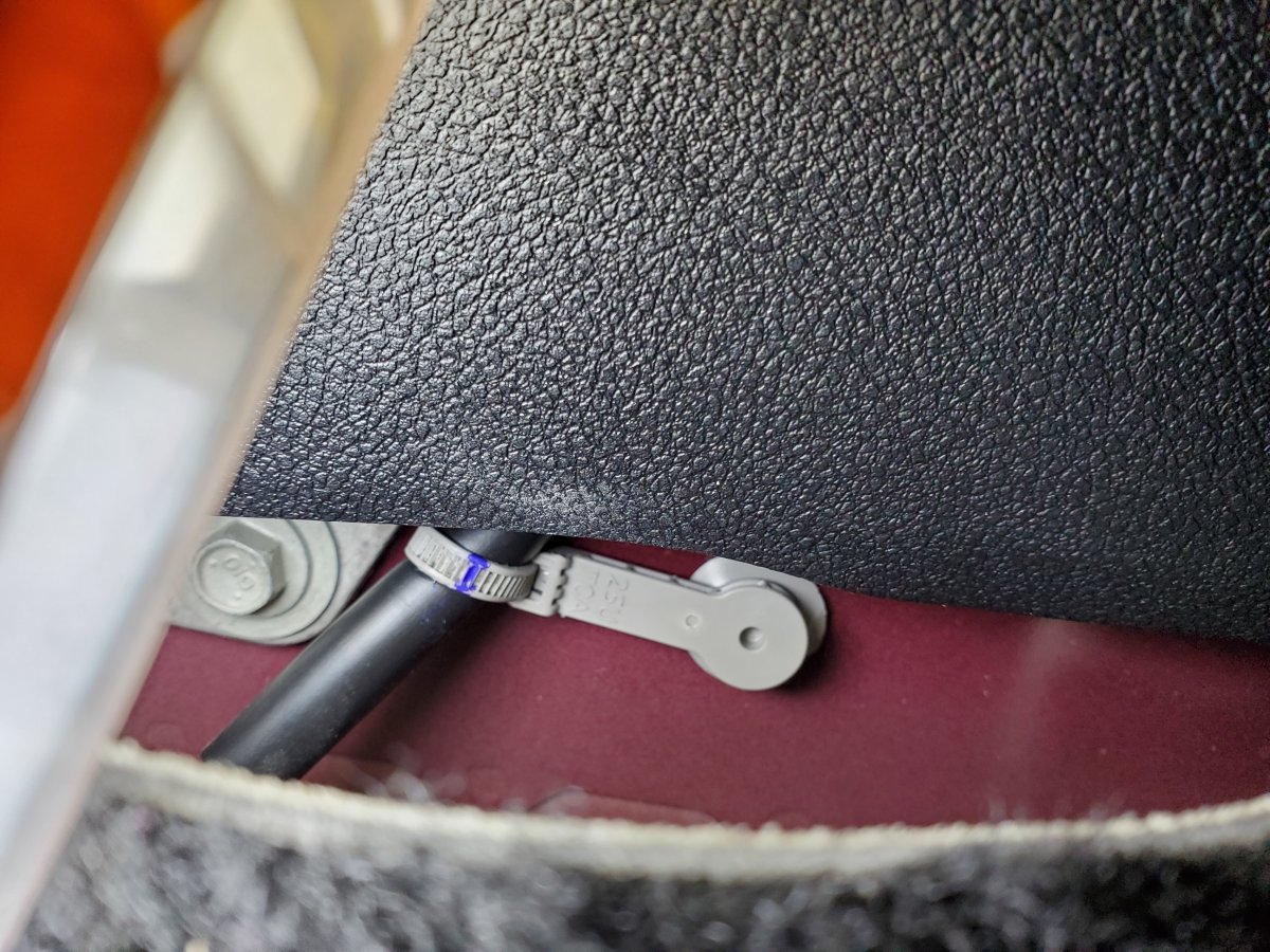

Ok, so I figured out a couple of sources of vibration in my 21 gt. The first is a plastic door where two heater rubber pipes go through the firewall in the engine bay right in front of the driver. I sured this up with heat resistant sound proofing material and I then went from the back side through the fuse box access and removed the brake fluid reservoir and placed heat resistant tape and sound proofing material on the other side as well. I hope the photos are explanatory. After starting the aviator and putting it into drive I still had a noise vibration inside the vehicle. I chased it down to behind the carpet along the transmission tunnel. When I pressed on the carpeting adjacent to my right leg, the vibration would stop. I loosed some of the plastic trim in that area and found a large wire vibrating along the transmission tunnel behind the carpet as in the photo. I sured this up and the vibration stopped. Hopefully, I have a vibration noise free aviator now. Will let you know when I drive it more.
