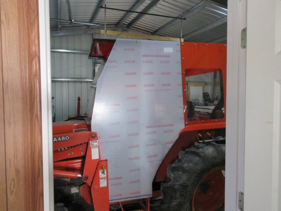

I finally decided to add a cab on my Kubota tractor. Getting tired of dealing with nasty winter weather when plowing my lane. I did look at pre-fab'd canopies and soft cab enclosures that drape over a canopy but decided to build my own. Not only were those pre-fab'd parts too expensive but they also would not fit over the rollcage I added several years ago.
Instead I bought three 4x8 sheets of clear .118" thick shatterproof polycarbonate, several 1-1/2" x 1-1/2" x 6 ft long perforated steel angles and a crap load of 1/4-20 nuts, washers and bolts.
I haven't made the doors yet but everything else is painted and installed. Speaking of paint, I decided because the plastic sheets are clear that it might make more sense to paint the inside surface rather than the outside. This is a work vehicle and I have been known to drive under low hanging tree limbs while brush hogging around the edges of fields and I didn't want those tree limbs to scrape all that pretty orange paint off. BTW, the paint is there mostly to provide shade in the summertime which also explains why I extended it down so far on the side and rear panels.

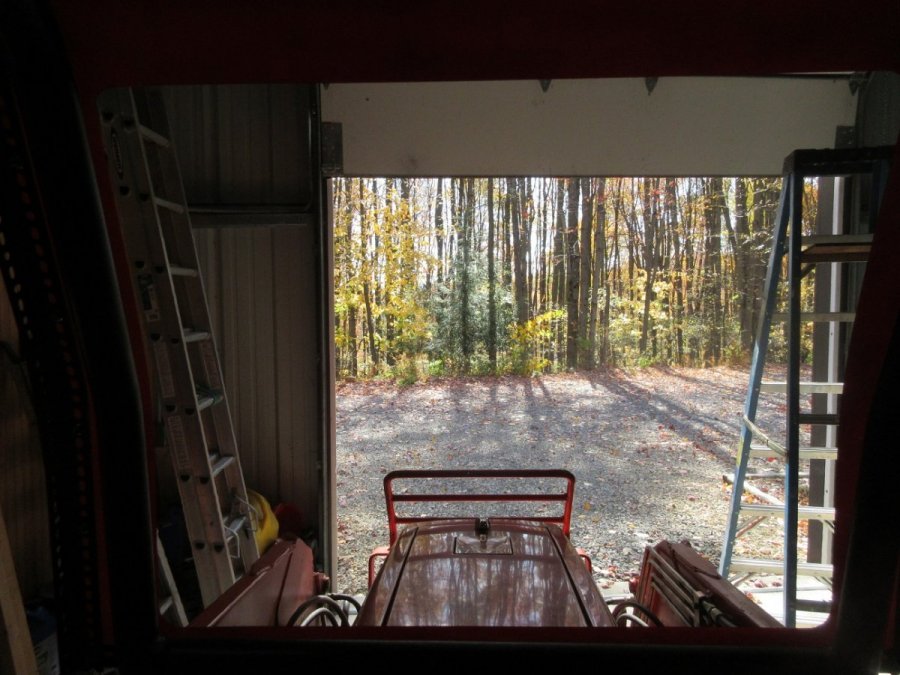

I was a little concerned about putting a bend in the middle of the windshield but it is surprisingly distortion free as you can see in the photo I took from the driver's seat. The front section of the rollcage was made from discarded 2" tubing that was originally part of a cage I bought for my Bronco. It already had bends where it fit behind the Bronco windshield and I decided to make the cab for the tractor fit the same contour. The tractor came from the factory with the rear hoop (ROPS bar), I just added to it.
I also included an extension of the roof panel over the windshield to try and keep at least some of the crap from the weather off and also to provide a little extra shade. The frame for that will also serve as a mounting surface for the light bar. I don't plan on taking it to Bonneville so I'm perry sure the aerodynamics will be fine. 😯

The one thing I was a little surprised by was how much of an echo chamber the cab creates even without any doors. That diesel rattle is really magnified in there. Looks like I'll be wearing ear muffs anyway. 😁
Seriously though, I was planning to close off the area below the windshield and beside the engine covers with sheet metal panels so besides keeping the wind and exhaust fumes out maybe that will also cut down on some of the engine noise.
