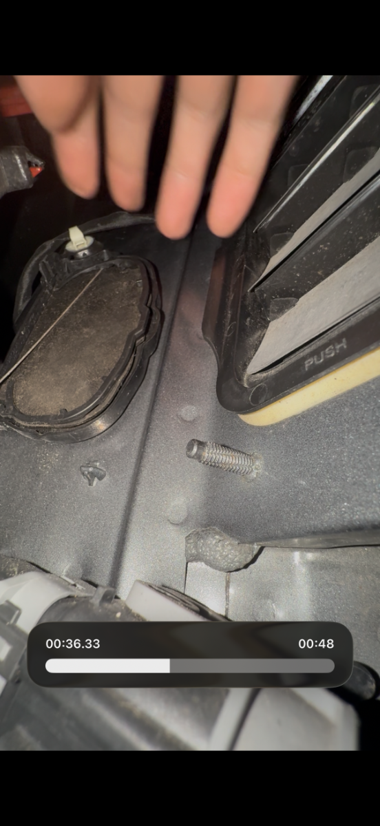

Zestyg Posted April 14 Share Posted April 14 (edited) On 11/27/2024 at 7:46 PM, CarlR said: We've had the same "Battery Saver" message since new on our 23 hybrid. Its been in to the Ford Dealership many times. First they replace the battery, which did the trick for about a month. Since then they've only been doing computer upgrades. Computer upgrades do nothing as the message comes back within 24hrs. From the sounds of previous posts here it sounds like the only possible solution is to upgrade battery at my own cost. Any other suggestions? With regards to the other issue on the flapping noise, we don't have that, but we do get a knocking/ticking type of noise under the passenger door when we do a cold (below freezing) start. Ford has not been able to replicate this noise yet. Old thread but because the flapping was driving me crazy too, it is actually part of the climate control vents. If you reach under and upwards to each side of your rear bumper, you will find 4 rubber (?) flaps (picture attached, ignore my hand). 3 of them lack any sort of actuator (the ones on the right) and one more oval shaped on has an actuator (on the left). The flapping noise primarily comes from the one on the left with the actuator when your climate control is OFF or on RECIRCULATE. When I was testing out the function with the help of my sister, your climate control being on either of those will cause air to not flow through the flaps (I do not know how, I couldn’t feel the actuator do anything the control seems to be further inside). When your climate control is on but recirculate is not enabled, air will flow freely through the flaps. This keeps them open and prevents the flapping, which I assume is accordingly turbulent flow pushing them open when they are set to be closed. This could be a faulty actuator on the larger flap. I duct taped the passenger side flap on the left down and left all other flaps alone. This solved 90% of the noise. The remaining noise is either the 3 flaps on my passenger side, or the larger flap on my driver side which seemed to be in better shape. Either way this mostly got rid of the noise without me having to worry about messing up my climate control system. Edited April 14 by Zestyg Quote Link to comment Share on other sites More sharing options...
