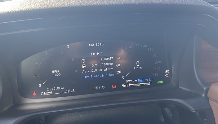

rampagex7 Posted April 16, 2020 Share Posted April 16, 2020 Has anyone else had their check engine light come on randomly on their Aviator and then turn off? This happened to me last week on my Aviator GT the light came on when turning on the car and the Lincoln app sent an alert on my phone at the same time. The light went off by itself the next morning. I couldn't bring it to the dealer to check it out because they are closed because of the ongoing lockdown. I eventually brought it to my own mechanic who checked the codes with his scanner and the trouble code that came up was "Lost Communication with ECM". Hopefully just a random electrical glitch but I was curious if it happened to anyone else? Quote Link to comment Share on other sites More sharing options...
mustangchief Posted April 16, 2020 Share Posted April 16, 2020 (edited) Yes. It came on three times for me when the charger was hooked up longer than 12 hours. Probably a software glitch. It always went away. I snap a pic and will let the dealer look at it. Take a pic and save it, so the dealer doesn’t give you the didn’t happen shrug. Edited April 16, 2020 by mustangchief Quote Link to comment Share on other sites More sharing options...

rampagex7 Posted October 31, 2020 Author Share Posted October 31, 2020 Had another instance of the check engine light coming back on today. Went to plug in my Aviator to the charger when I got to work this morning it started charging normally and after about 20 minutes I saw the charge port light when solid red everywhere (which is supposed to indicate a charge fault of some kind?) so I unplugged it and left it alone for a few minutes. I plugged it back in and then it started to charge normally again the lights went blue again and it charged it up to full. When I left work and turned on the vehicle the check engine light was on solid and the Lincoln app chimed up as well. Luckily I just recently got one of those BlueDriver Bluetooth OBD scanners so I scanned it myself and came up with several trouble codes U0100 and U0111 which looks like a loss of communication between the ECM and BECM. (see attached report). I'll bring it back to the dealer on Monday and let them look at it, maybe there's a loose wire harness on one of the modules or something. @mustangchief are you still getting the check light coming up on yours? What happened when you brought yours to the dealer? scan_2020_10_30_07-27-14.pdf Quote Link to comment Share on other sites More sharing options...
