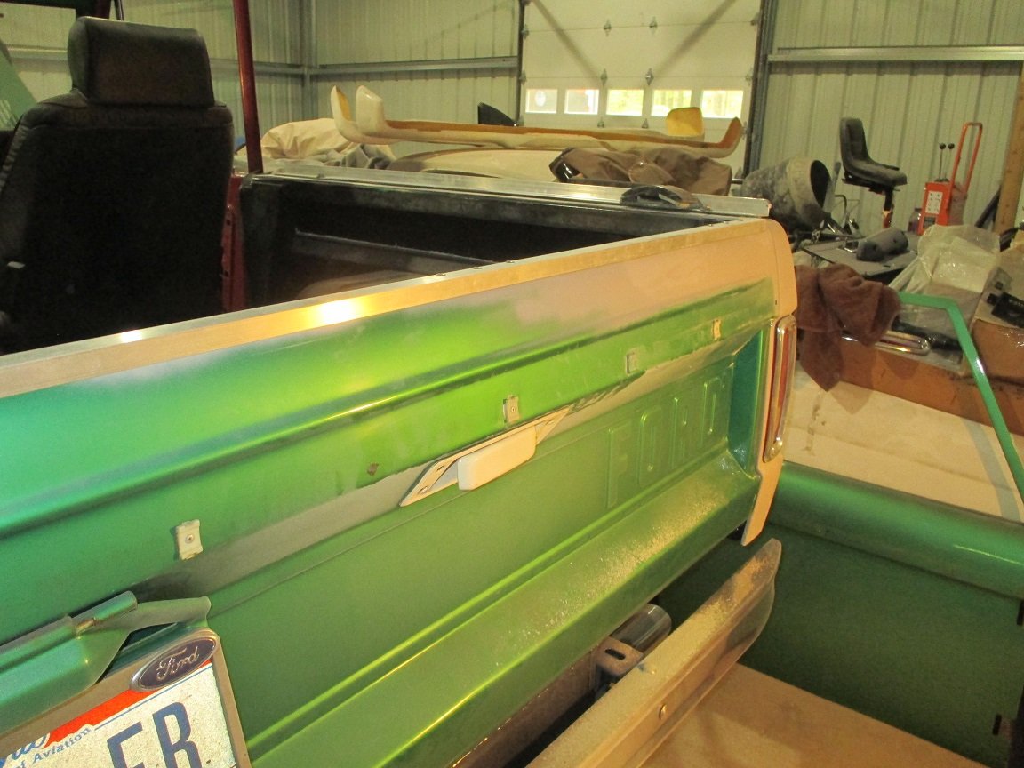

I also did some damage repair on the tailgate. Someone either backed into something with the tailgate down or a tree or something fell on it because it was dented. It's weird though because there was a dent near the top on the outside and inside faces but not on the top edge. There was about a half inch of bondo on the outside where someone tried to fill that dent. It actually looked fine except that rust had either started or was always there under the bondo and it had started to crack. After removing all the old mud and rust I used a slide hammer to pop the dent out as best I could and then applied some fiberglass reinforced bondo. I suppose the right way to fix that would be to cut out the damaged metal and weld in a new piece. Or just pay $425 for a new tailgate. Maybe someday. The good news is that most of that area will be covered by an aluminum piece of angle which is what the rear window of the soft top attaches to.
Ah the joy of working on a 45 year old vehicle.😉
