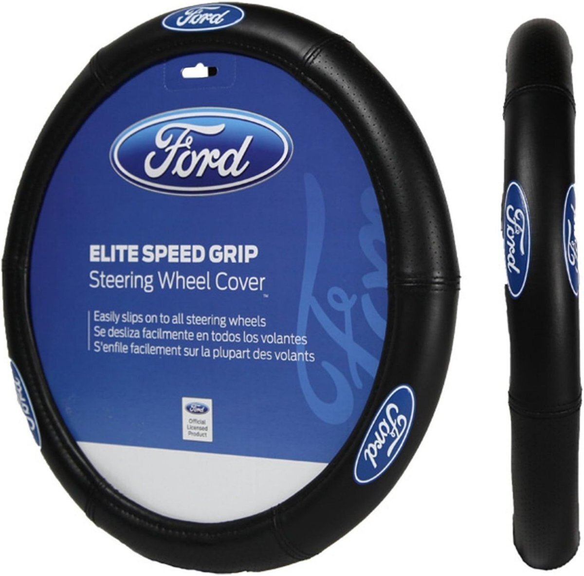

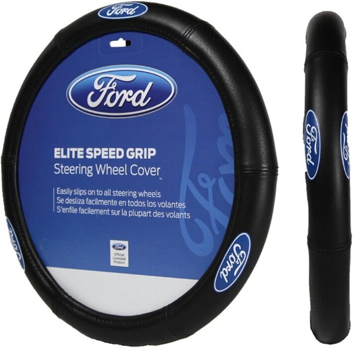

twintornados Posted December 30, 2024 Share Posted December 30, 2024 Assuming this is not an option? Available on Amazon for less than 25 dollars.... Quote Link to comment Share on other sites More sharing options...
