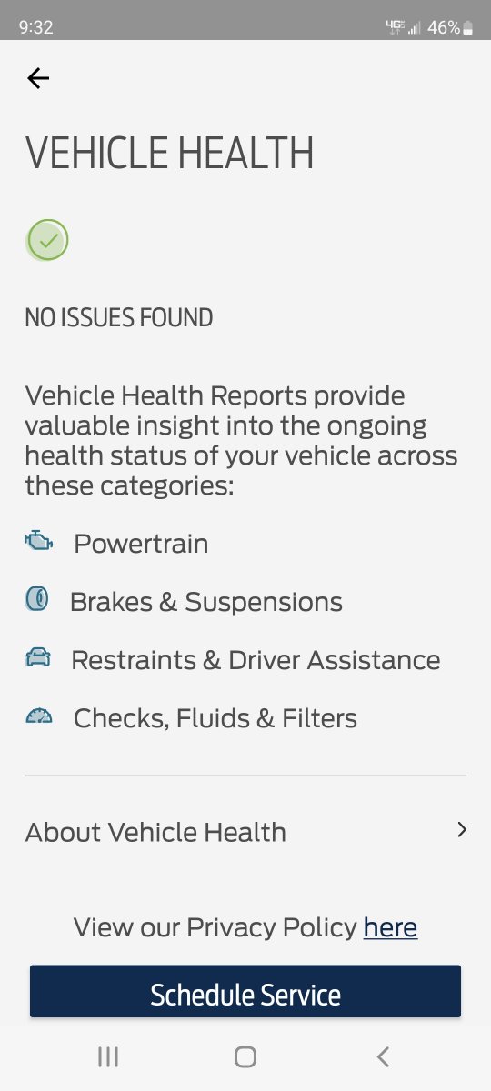

IUEC135ELEVATOR Posted April 28, 2022 Author Share Posted April 28, 2022 Have ford pass....but all I see is tire pressures, remote start, location, recalls ect ect. When I go under vehicle health I see this. Lots of info...but nothing about codes (I do see i have a wiper recall?) Quote Link to comment Share on other sites More sharing options...
Sceve Posted April 28, 2022 Share Posted April 28, 2022 What you see in Ford Pass is a very basic version of what Ford employees and technicians can see. The Ford diagnostic website has a very detailed report of every code that sets and when it set, but only certain Ford dealer and corporate employees have access to it. 1 Quote Link to comment Share on other sites More sharing options...
