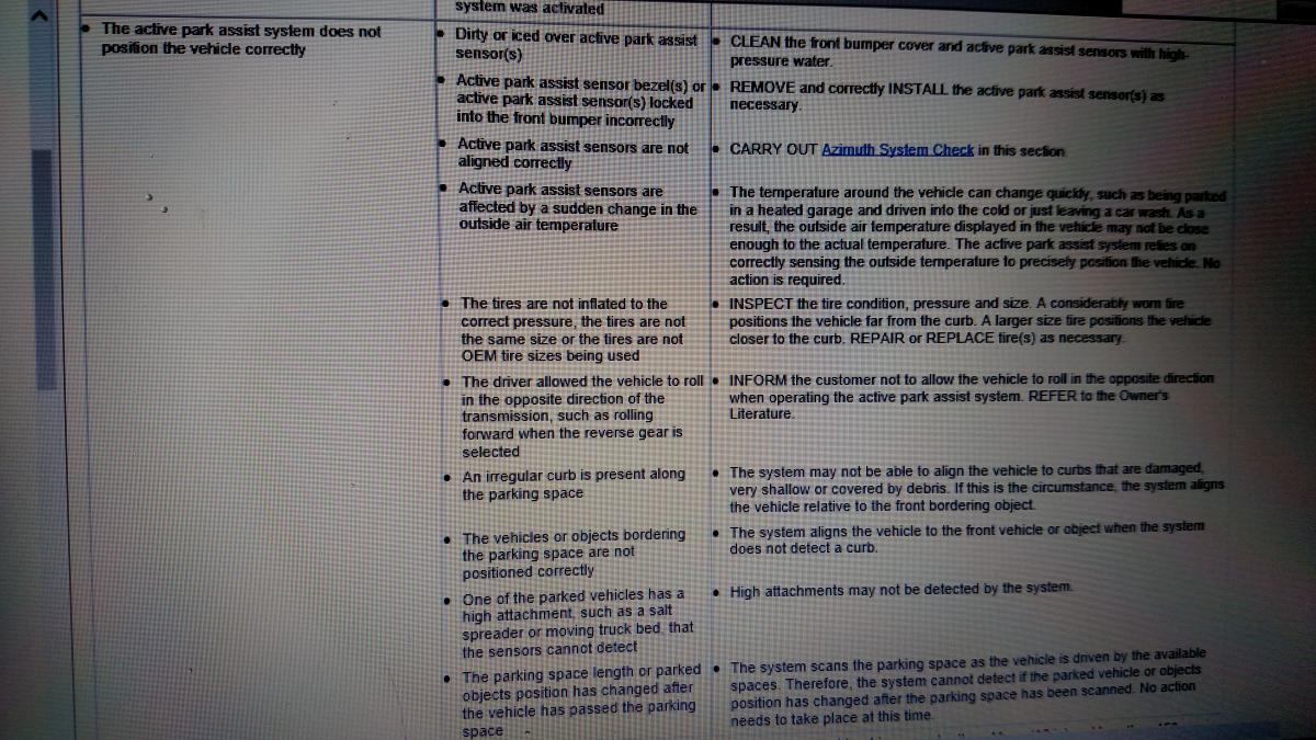

The sensors are ultrasonic. It is possible that the sensor is not reading correctly. There is a procedure to check the alignment of the sensor in the work shop manual.

They need to do a Azimuth system check. That will tell you if a sensor is reading accuratly.

Here is the WSM symptom chart. Sorry for the low quality picture.
