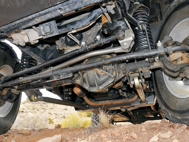

RichardJensen Posted January 25, 2009 Share Posted January 25, 2009 (edited) how is the Wrangler done? See for yourself.... Crowded, yes, but the differential and torque tubes fit under the engine. I believe you're looking at the oil pan immediately behind and to the left of the differential. Obviously not a setup that could fit under a car with a conventional cowl height... park a Jeep next to a car sometime and you'll see how much higher the cowl is from the floorpan. Edited January 25, 2009 by RichardJensen Quote Link to comment Share on other sites More sharing options...

rkisler Posted January 25, 2009 Share Posted January 25, 2009 Likely they could not share a frame going forward from the firewall, and here's why: AWD capability If you adopt a low slung engine design (as in passenger cars), it creates all sorts of expensive issues for the front driveshafts. On Bimmers and Benzes, I believe at least one of the half shafts runs =through= the oil pan. Lowering the engine in an Explorer to passenger car acceptable levels (that is, a shorter cowl height) would require similar maneuverings with the front driveshafts. And while you could (conceivably) get by without AWD on a cop car, you'd need it on the Explorer. -- Conversely, with transverse AWD, the front drive shafts are already there, off the transaxle, and don't have to be 'squeezed' in. That's a major reason why AWD is very expensive on the 300, and very cheap on the Fusion ($1500 option on Fusion and IIRC $5000 on the 300). --- Going backwards, you'd never see a perimeter frame on a light truck because of payload weight distribution: you want the bed to sit on the frame rails, as opposed to being suspended between them. Also, you can't split a frame at the B pillar. You'll see frames divided at the firewall, but never in the middle of the cabin. Finally, the Explorer is going unibody anyway. Richard, I support this post and would like to add a few tid bits. AWD in RWD vehicles 1. How this is laid out depends on the ride height you want to end up with. You are absolutely correct in saying that car-based RWD applications involve a takeoff from the rear of the transmission with a shaft that goes forward and then through the oil pan. In truck/SUV based products, the ride height is higher and you can go underneath the oil pan. 2. If a car is designed from the beginning with AWD, it's a lot easier (and less expensive) to add it as an option. The packaging of the AWD can be a pain. First, you have to bump out the floor for the tranfer case, then you have to find the right place to put the shaft in the front (you need to run it through the oil pan at a main bearing to keep the height low), then you have to get the shaft to the wheels. Often times, there is a big tearup -- body structure, engine mounting, suspension arms, knuckles -- that could increase investment to the point where it's not worth the trip. And sometimes, the physical layout could result in angled shafts that can have undesirable effects. 3. The Panther was studied for AWD on at least two occasions. I can guarantee you it's not worth the trip. Frames 1. You are correct that there is a fundamental difference in frames between a car and SUV. And they are not compatible. It has to do with ride height and flat load floor vs. the ability to be down lower for good entry/egress. 2. There have been some suggestions for a combined BOF car and SUV. It's been studied. Forget it, unless you are considering a Presidential limo. 3. You are correct that you wouldn't have a frame that was "half and half". 4. Of course, as you mentioned, it's a moot point anyway, as the application of BOF for Ford will be limited to trucks and large SUV's. As we have all mentioned numerous times, the Panther is going down for the count. It is apparent that Ford will not put any further investment into this ancient platform which has served the company well. And I think that Ford in hindsight would like to have back the investment it took to move the Town Car to St. Thomas. You can't make a business on cop cars with the present facility at St. Thomas. Cop cars represent 50--60k, but a single shift at St. Thomas is around 120k. With the fading Panther retail volumes, and pressure for higher fuel economy taxis, I don't see any possibility of filling the rest of the shift. I don't think any of us know what investments would be required to keep the Panther current just for environmental and safety regulations. And expending engineering effort on this platform which is not part of Ford's future plans is just a distraction. So it would seem the D3 would serve as a good basis for future cop cars -- both in Taurus and perhaps Explorer guise (although a Flex paddy wagon would be pretty retro and cool and I think -- imagine bars on the windows!). But it would also seem to me that there should be consideration given to the upcoming Ford c and c/d -based people carriers for local duty. Quote Link to comment Share on other sites More sharing options...
