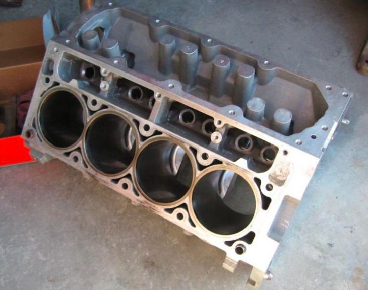

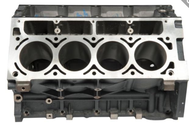

ESP08 Posted March 8, 2021 Share Posted March 8, 2021 1 hour ago, 7Mary3 said: The LS has 4.40" bore spacing and a shorter deck height than the Ford 7.3L, so generally speaking it can't be built as large. Largest production LS has been the 7.0L, but the aftermarket tall deck LSX block can go a bit larger than 7.4L. One feature of iron LS blocks is that they have generous cylinder walls and can tolerate substantial boost. In particular, the new Gen. V 6.6L has a particularly heavy (245 lbs.) iron siamese bore block casting that I am told it can be bored .060" out for boosted race applications. The 6.6L has a forged crank like the 7.3L and also has very substantial nodular iron main caps. The block and crank are already in the GM Performance catalog. Medium duty truck engines are typically not rebuilt or replaced, they usually last the economic life of the whole vehicle. This is true with both gasoline and diesel engines, note the majority of mid-range diesels are 'parent bore' blocks. They do not use replaceable cylinder sleeves like heavy duty diesels do, which are typically rebuilt during the trucks economic life. I don't believe the PTWA process is used by any engine rebuilders at present, and is probably not cost effective. Cheaper to buy a new block. Typically the smaller bore LSs are a lot better at handling/sealing high cylinder pressures than the larger displacement LSs. LS7 vs 5.3, note the difference in the amount of material between the cylinders. 1 Quote Link to comment Share on other sites More sharing options...

7Mary3 Posted March 9, 2021 Share Posted March 9, 2021 5 hours ago, ESP08 said: Typically the smaller bore LSs are a lot better at handling/sealing high cylinder pressures than the larger displacement LSs. LS7 vs 5.3, note the difference in the amount of material between the cylinders. Yes, and the iron blocks are more stable as well. The LS7 has cast in iron liners with a 4.125" bore, and that's about the reliable limit for a naturally aspirated aluminum LS block. 6.2L's and the new iron 6.6L are 4.060" bore. Quote Link to comment Share on other sites More sharing options...
Stray Kat Posted March 9, 2021 Share Posted March 9, 2021 So are we all keeping in mind that the photos of the GM engines are of deck detail whilst the Ford picture is a cutaway showing actual cylinder wall? Notice the oval shaped major diameter I believe first pioneered on the mid-80’s 5 liter blocks. These of course put emphasis on the thrust sides of the cylinders. I must admit General Motors has always been generous with wall thickness in many areas of their various but not all V8 cylinder blocks. The Ford approach appears to me to have always been accurate castings with “engineered” wall thicknesses to save weight and probably costs. When I worked for an engine rebuilder I used to cringe when the big block Chevy stuff came across the bench. You’d truly have to wrestle that stuff around. I always thought if they felt that much like an anchor on the workbench, think about what a counterweight they must be in any vehicle that is intended to have some decent driving dynamics. It’s no wonder the little 289 GT350 Mustangs used to give the Corvettes fits in road racing. The bitty block Ford was a flyweight powerhouse. 1 Quote Link to comment Share on other sites More sharing options...
