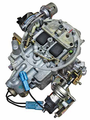

edselford Posted April 11, 2021 Share Posted April 11, 2021 Yes, I don’t know why I forgot to mention the 2700? Might be my age! This model utilized two main metering rods, one for each bore opening. The idea was to meter fuel across a constant delta pressure! From what I understand, there was a third metering rod used for cold start enrichment. Years later, I had a 1979 Ford LTD that had a 351W with one of these carburetors, In subsequent years, It was also modified to compensate for altitude because engines needed a richer mixture at altitude but the fuel systems that were open loop went too rich at altitude! edselford Quote Link to comment Share on other sites More sharing options...

92merc Posted April 12, 2021 Share Posted April 12, 2021 8 hours ago, twintornados said: Lets also not forget Ford's variable venturi carburetor efforts as well... Variable venturi sucked ass in the winter. Mine would either freeze open, or freeze shut. Those slides just didn't work well when the engine was cold. 1 Quote Link to comment Share on other sites More sharing options...

theoldwizard1 Posted April 13, 2021 Share Posted April 13, 2021 On 4/11/2021 at 3:19 PM, twintornados said: Lets also not forget Ford's variable venturi carburetor efforts as well... The old 2100/2150 was called "the worlds cheapest carburetor". The VV (2700/7200) was called "the worlds most expensive carburetor". They were manufactured in Rawsonville, MI. Final calibration was done is "climate controlled" room. Temperature and pressure were held to close tolerances. When they worked, they worked well. When they did not work the service manual said "replace; can not the rebuilt". Segue - the 7200 was the electronic version. It had a stepper motor that controlled the A/F ratio. I actually wrote some of the software for the EEC-II/III that controlled that carburetor. 1 Quote Link to comment Share on other sites More sharing options...
